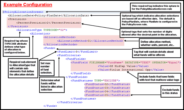

An explanation of the types of models supported in OIPA is provided in the Allocation Model section of this help. An XML example of the OIPA PolicyAllocationScreen business rule configuration is also provided.

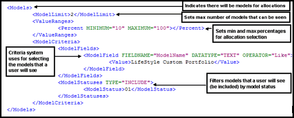

Add the Allocation Model in the appropriate business rule (PolicyAllocationScreen or TransactionAllocationScreen) according to where the model will be used in OIPA. These business rules store the allocation instructions for the varying allocations that may be presented at the different levels in OIPA.
Check allocations in OIPA to ensure they have been configured properly. Navigate to the appropriate screen depending on the configuration:
Basic Allocation Configuration and Fund Selection
Configuration Showing Allocations in Models
